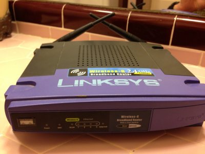

You use an ethernet switch. That would connect to your cable modem, then each wifi hotspot would plug into the switch - your bandwidth in and out of the house is unchanged. You're just giving the cameras their own wifi hotspot to connect to, which frees up available wifi bandwidth on your AirPort for your other devices to use. The cameras will still be able to do what they've done before, on wifi space that's not competing with your other devices.
I have this lying around, but it still works fine as far as I know. Will it get the job done as a second router?ImageUploadedByTapatalk1355530473.266398.jpg
