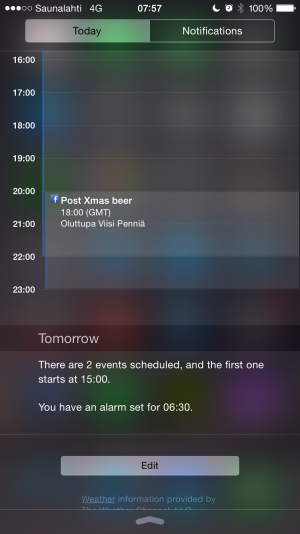

Is there any way to prevent my Calendar from displaying in GMT on each event?

I have the same issue. Creating events on the iPhone & iPad, appears correctly at first but within a few seconds shows GMT in brackets. When I try to edit the event, only GMT time is shown. A real pain in the A! Have to re select Adelaide time zone and correct the times, then Ok from then on. Is this a known bug? Will it be fixed with iOS 8.2?

This has recently started on both MY iPhone and iPad. Have my calendar synced with my Google calendar, May have started after 8.1.2 download. Whatever changes I make it always shows the GMT time zone. I googled this problem and many people on IOS are having this Issue. Someone HELP.

Yes, If you imput all your calendar data in Google calendar activate the "time zone" and highlight your timezone press-done, then save. Then go to your Iphone/Ipad calendar program, press edit on the event that is showing the "GMT". Click on the start time with the gmt then press save and the darn thing will disappear off you calendar.
