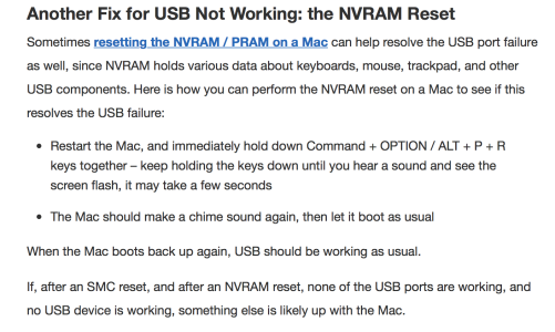

I found something and I think it helped!
google dthe problem and found this link: Mac USB Ports Stopped Working? It?s Likely Easy to Fix | OSXDaily
You don't need to open it. What I did was "the NVRAM Reset"
All I did: restart the Mac, and immediately hold down Command + OPTION / ALT + P + R keys together.
The phone is plugged and charging fine(10minutes. It didn't charged 1 minute before this) ! I'm so happy!!!!!!!!!!!!!!!!!!
Hope this helps others... :)
I'll update this topic if something changes! ;)
print screen from the website:
