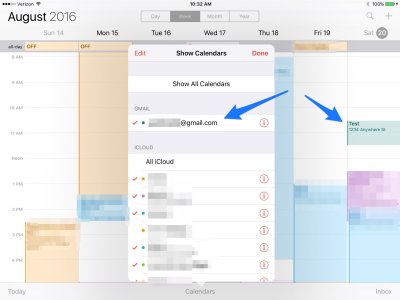

Is it safe to assume you have the toggle next to Calendars enabled in the Mail or Mail, Contacts, Calendars setting for the account?
Just_Me_D
Moderator
Jan 8, 2012
60,414
885
113
I'm currently on my iPad Pro. After reading your second reply, I logged into my gmail account, via the Safari browser on my iPhone, and then created a test event on my Google Calendar. Afterwards, I enabled the toggle next to Calendars in the Google Mail settings on my iPad Pro. Immediately, the event synced to it.
Try rebooting your device or resetting all settings.

Also when I look under the calendar on my I pad pro not listed in the calendars see it in my settings for some reason it's not on the actual calendar itself in the settings
Trigati
Sep 1, 2015
209
Make sure you have your Google account added to your Calendar in the Settings (that's the Gear icon) of your iPP. Don't even open the Calendar app at the moment.
Open 'Settings', tap 'Calendar', tap 'Accounts', then add your Gmail account. Once it's added, tap it and make sure Calendar is selected. I'd also suggest you tap your iCloud account and turn the iCloud calendar off (it may spit out a warning about deleting the iCloud entries, but that's what you want), so that only your Google account controls the calendar.
Once that's done, check your calendar and see if its synced properly now. It should be.
I only use my Google account for my calendar and I have both Android (Nexus 6P, Pixel C) and iOS (iPad Air, iPod Touch 6) devices and everything syncs properly between all four devices if I add/change/delete an event on any one of them, so it doesn't matter if you have an Android phone and an iPP as long as the iOS settings (which are a tad un-intuitive honestly) are configured properly.
